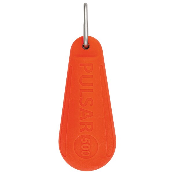

I really like the hard ball I got for positioning. In retrospect, I should have gotten the Pulsar, but the 12oz ball works ok. I like it specifically for manipulating the line through the canopy. Throw a regular bag, let it drop, then hook up the hard ball for positioning. It's not essential gear, but it's a nice addon to the kit that makes life easier in the right trees.
This is the one I should have gotten...
I got the 12oz Meteor, cause 12 is my preferred weight, but I like it better as a manipulation bag than a throwbag. They're expensive, and not absolutely necessary, but you can make them dance in the limbs. It's a nice tool to have for trickier setups.
