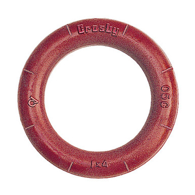

Does anyone know where to get a large steel rigging ring?
