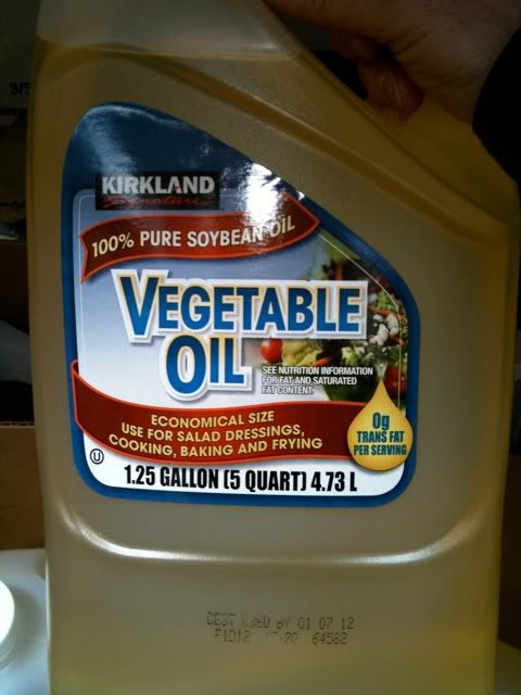

I've been using (and paying extra) for Stihl's BioPlus with vegetable oil. What would happen using something like these?
Canola only from what I hear. I'd been BioPlus all the way, until switching. I hear cold pressed canola is better. Some people run their chains a bit looser with canola. Others say only for smaller bars. At my new job, we only use canola, even on 60" bar, but might wear more. Dunno.

FWIW - for 2 years, I've only used the exact same Kirkland Canola in the second picture of the OP. My experience with canola:
Saws see a lot of use through the winter - canola works better in cold weather, about the same in summer.
Saws sit more in summer (thin & deadwood mostly with hand tools) -- have not had any gumming problems, it does 'leak' out though.
When running, the chain 'throws' about the same amount as petroleum oil -- does that mean it's tacky enough???
If the bars wear more I can't measure it -- does that mean it lubes enough???
For one entire summer before adopting the use of canola, left an open jug in the shed -- no discernible change; canola did not 'go bad' or turn rancid.
I've read canola oil is pressed from a cultivar of rapeseed, hybridized for human consumption -- does that mean it's more biodegradable than petroleum???
HO's like that I'm using it -- works for me.
