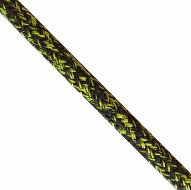

Looks like oceans polyester.... but you said 12mm? I thought oceans mainly came in 8 and 10 for arborists, but by the color and pattern that really looks like oceans. I do know it's used for sailboats too, and likely in different diameters, so maybe that's where he got it. Used like that it is going to be hard to splice, i think oceans has a reputation of being fairly hard even new, but most double braids with tight covers can be.

Hmmmmm... that really really looks like oceans.

I think Kyle is right. It’s possible it’s something completely different too, there’s a lot of manufacturers out there that aren’t so common.
Did you try burning the end a little, and see if some melts and some just chars a little? Might tell you something. Ocean is polyester and aramid, although not sure if it’s 50/50 or what.
Does anyone have a piece of 10mm Ocean they can check the diameter of? There’s an insane amount of variation in cordage, even different products from the same manufacturer will have significant differences yet claim to be the same.
I’ve heard it’s measured when loaded with a 50lb static pull, but I’m not sure how true that is or if different manufacturers measure differently.
I know I have a few climbing lines of 11mm that look thicker and thinner, and a bunch of 8mm cords that look as thick as some 10mm I have, and some Epicord 9.3mm that’s thicker than some 10.
Lots of variation out there.
Smart to learn exactly what you got though. I have a nice eye and eye that I won’t use because idk what it is yet.

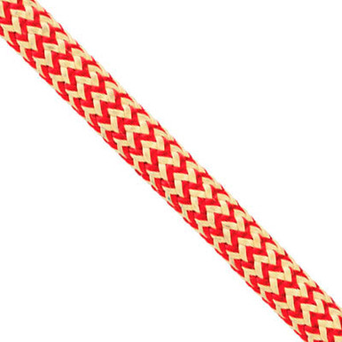

I think ocean has an aramid cover over a poly core. After the weaver cougar (which is what i run), i made a decision to only run poly core ropes, and i bought some oceans and armor prus poly. I also just looked and our sponsor is no longer carrying the armor prus poly for some reason....
The cover is 50/50, the red or green colored fibers are polyester and melt like the core. The natural colored fibers in the cover have the slight yellow of the kevlar and don't want to melt at all, just burning. Finishing the rope's end with a flame is plain ugly.
