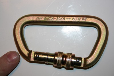

I use steel screw lock crabs that are never used for life support, only rigging. Since as we all know, screw locks are frowned upon for life support in tree work. I buy two different brands basically..
I can sometimes get them on Ebay.... And they work just fine. AMP product.
http://www.ebay.com/itm/290509808924?_trksid=p2060353.m1438.l2649&ssPageName=STRK%3AMEBIDX%3AIT
Or from WesSpur. Sqwerl turned me onto them. Kong Product.. Also work great. Rated 50kn as well.
http://www.wesspur.com/carabiners/screw-locking-carabiners.html
I have had great service from both. Only retired 3 of 20 just out of shear abuse on the mini mostly....
