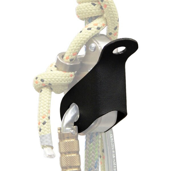

If so and he’ll return it I’ll gladly send it your way. I have my original HH and one of Richard’s HHXF. I also have some of the material to make a *HUT (Wesspur calls it a ‘Holster’)for advancing it - as developed by Walter Haulenbeek. I can cut, heat, and bend one up for you.

Don't hesitate with the Holster for an HH.
I faffed around for years with cord, got a Holster last year, bees knees like Stephen says.

I have one traced out on a flat sheet, ready to be cut out, heated and form-fitted. Wesspur would get one there more quickly, already formed, but if you’d like I could send this one out to you.
