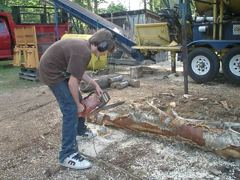

here's my skid steer at work.
the pile of wood with snow is this winters haul, it's already sitting in some one's elses yard drying :D
the others are this spring's haul,heading out daily :what:
and my boy taking his first shot at knot bumpin' age 13. and he's running the processor while i load the deck :\:
we all gotta start somwhere :|:

William G, welcome, always nice to see some new blood on the forum, good to see your young man getting in the mix, hate to be a nay sayer but he needs some PPE. :) chaps and eye gear would be a nice start to a safer career.

IMO, eyes and ears are a near must, Chaps are situational. If they weren't so effing hot, then it wouldn't matter, but I'll pass on the heat stroke and roll the dice on getting cut.
Cutting on flat ground with solid footing is far different than cutting in thick brush, on a hill, in the rain.
