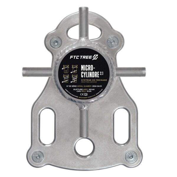

I highly recommend the FTC MicroCylinder.
