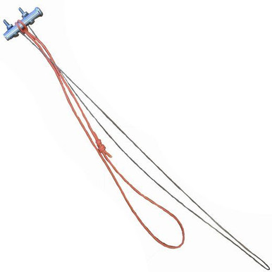

I forget what these things are called but they are great tools when extracting the core out of the cover. I use them the exact way shown in samson double braid video how they extract the core. I just find the little hook on them grabs the core great and they are dull on the ends so that they dont pick the core while feeling around.
A crochet hook, used to make the lace. The hook's size is function of the thread's diameter. It allows to grab the loose thread on the back of the lace and pull it through toward the front without catching the already woven ones (actually just the same thread from start to finish)..

I think im going to turn my wire fid into a wire fid like this! It would be nice to have a handle on the end.
