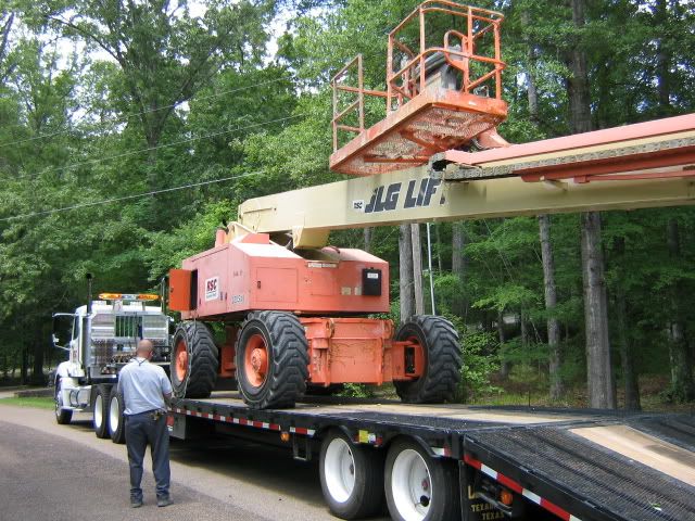

Ditto what Carl said. There's a reason why most successful tree companies do not use a JLG lift. When I was looking at bucket trucks my father thought a JLG lift would be wonderful, but that pretty much shows how little he knows about my work.
The JLG is just as heavy as a bucket truck, it's just as wide as a bucket truck, it must be transported to the job on an oversized trailer requiring yet another big truck to pull it (your pickup won't cut it) and the final disadvantage is that you don't have as much side reach as a bucket truck so you're constantly working over top of the base unit.

Here is a 120' JLG from a few years ago. It's trippy driving around 120' in the air.
I have also used an 80' articulating.
