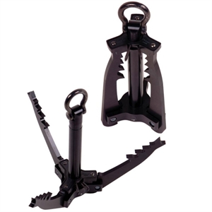

There are times when I think, damn I need to just get over there ** feet, in the tree, too far to swing.... Just today, I had to have the groundsman swing me to where I wanted to be... but having seen Reg with his grapple ($230) I'd like something similar but not breaking the bank lol. When I was in Sweden a guy had what he called the secret weapon, just a bit of twisted up metal he would use to grapple rounf the canopy ha. What do you guys use?
LOL....
This is what I think we were looking at when I was talking to Gord about it. Can't find the thread.
Couple bills though...
http://www.apexxgear.com/products/338-grabber-collapsible-grappling-hook.aspx

DMM hook is about ready to come out right? That will be easy to carry and work a lot of the time. After years of fighting to get over to other trees in a grove I saw Reg's vid and bought the Batman looking black military model shown by Stephen, haven't used it yet. One job and it will earn it's keep. Funny, pre-Wraptor I traversed wide spaces all the time.
That small Stainless grapple on ebay that is made in China was next to something where I could judge size better at one time. I think it is pretty small.

For $30 i ordered one to see if its any good, will let you know.... The specs are on the ebay page.

They dont have to be huge. Just heavy enough to pitch over and large enough tines to grab a limb. I think Gord had a tennis ball on the shank to help with flipping over branches better.
