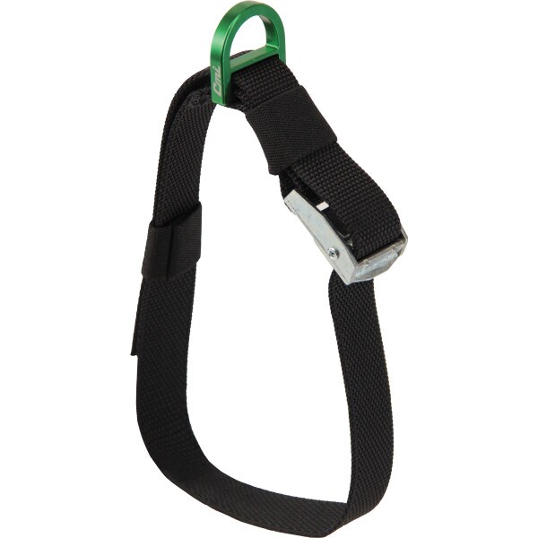

I want to try to make something like this for my secondary truck kit. For footloops, I like the way this one looks. I'll probably get it if I have to buy one...
