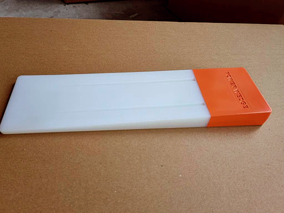

When my Saw Shop started stocking them regular , I asked if they are any good and worth the price. Mechanic said , "Some guys like'm , some guys don't." .... I actually like them but it's usually only one mixed in with the group. Also never failed one like that pic
Had a couple do that to me. No biggie 6 to 8 more inthe truck. They always make their money and dont owe me anything by the time that happens.
Kids finally got that last one like that free from the grey pine stump. Left it there after felling the tree. Realised I had a couple days later. Glued to the stump. Its been, 3-4 years :lol:
Was it caused by like a glancing blow or a hard strike to the edge or something?
I expect wedges to hold up to that kind of abuse anyways.
Betcha if you contact the manufacturer with that pic they’ll send you another.
First off that is a piss poor weld glancing blow or not. I might just return that one as a defect.

One side of the plate had a good wield but only really tacked the shank. The other wield wasn't secure on the plate. I was confused that it happened.
The weld was not hot enough to penetrate the striking plate. Obviously the weldor has no clue how to weld or set the machine properly. As I am sure Kyle will write more on this topic but in a nut shell with MIG welding you can make a nice looking weld bead but have no penetration into the metals being joined. A weldor needs to watch the molten weld puddle and make sure both pieces are liquid and the filler metal connects both puddles. If you look at where the one weld broke off of the striking plate it almost looks like it was never even welded on in the first place.
It's all about penetration boys. If it's too cold, you don't dig in the other metal, so nothing is held. Mig is fast, but new guys run it too cold most of the time, so it's often worthless. You would be amazed at how many things that just "break" do so because of improper welding.
Are you saying guys fail to warm up things properly, rush, and hope for good penetration, and have poor performance?
Getting things heated up and ready is learned over time, with attention to detail, and many guys repetitiously fail.
With welding it's in the settings, so it's instant, but if i was correctly picking up on the double entendre..... then yes :lol:
