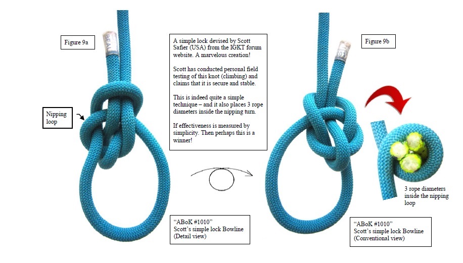

I like the Scotts Locked Bowline. The Spyder posted an article that had it in there, and it caught my attention. Simple and elegant...
That definitely looks cool, but for a life support the Yosemite tie off works so well that it's kinda "the way." I bet that would be awesome for heavy loading tho!
